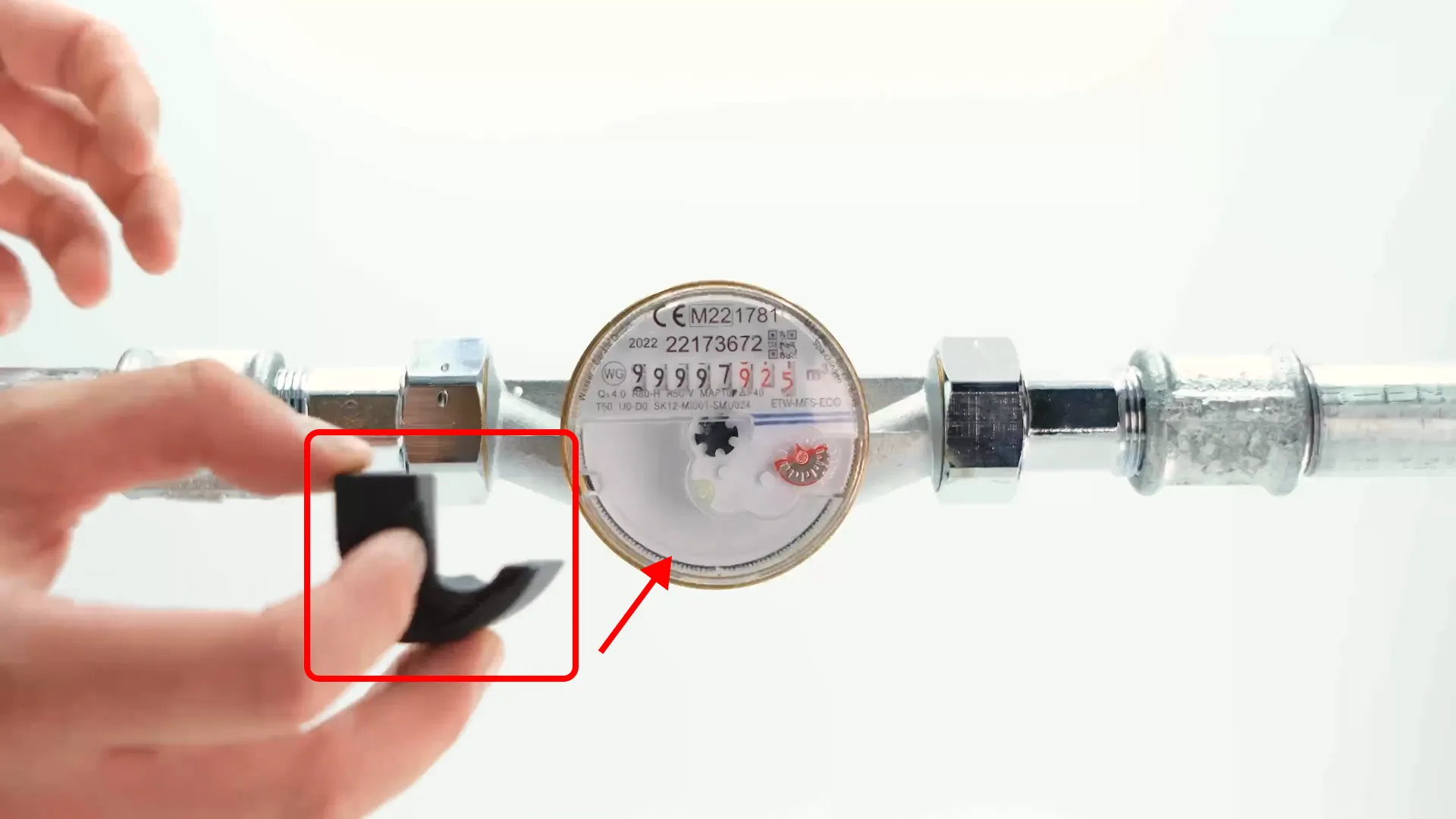

Step 1: Position the Adapter
Insert the adapter into the indentation on your water meter. Ensure it fits snugly into the groove.
Adapter setup in groove
Adapter placed in water meter
Key Points:
  • The adapter should fit securely into the mounting groove

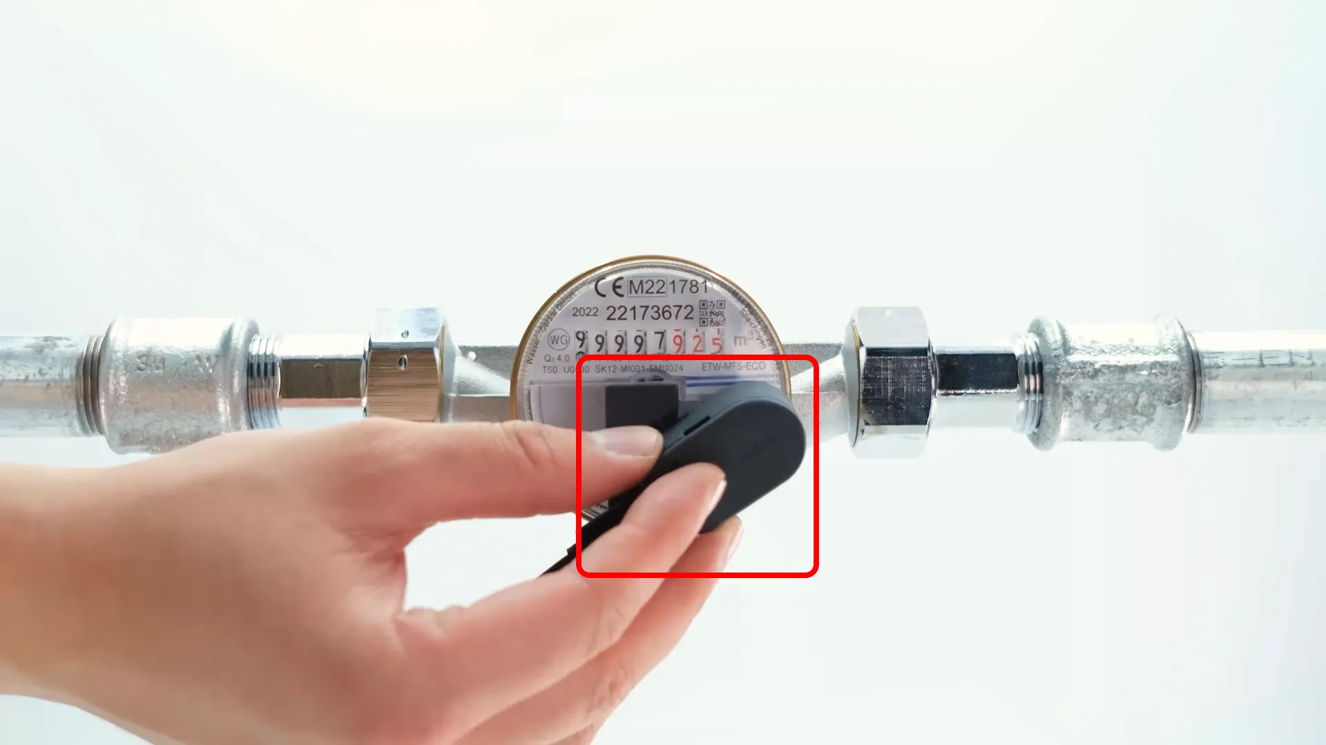

Click-in Installation
Push the adapter firmly until it clicks into place. The adapter should be stable and not move.

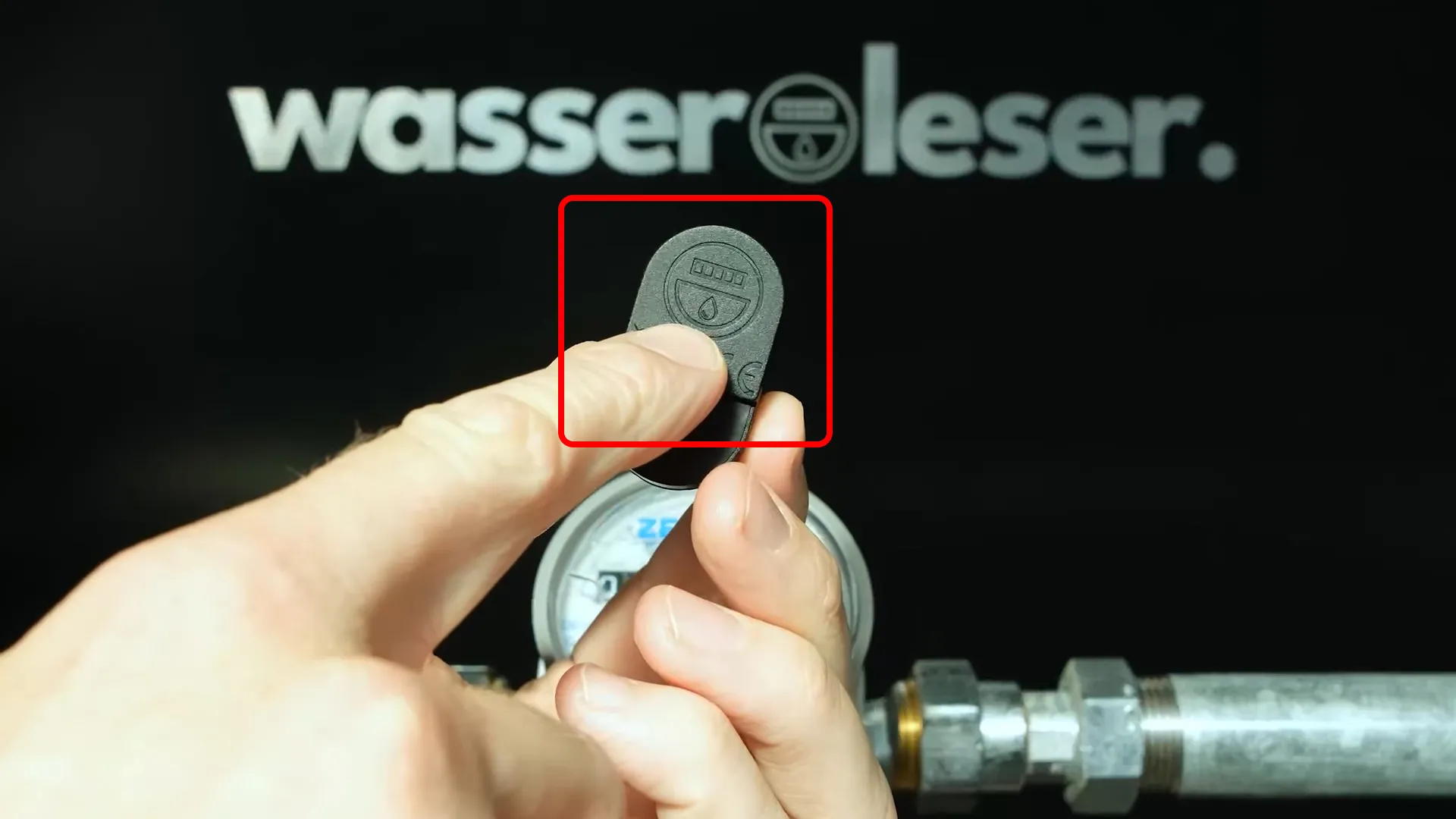

Step 2: Attach the wasserleser
Place the wasserleser device onto the mounted adapter.

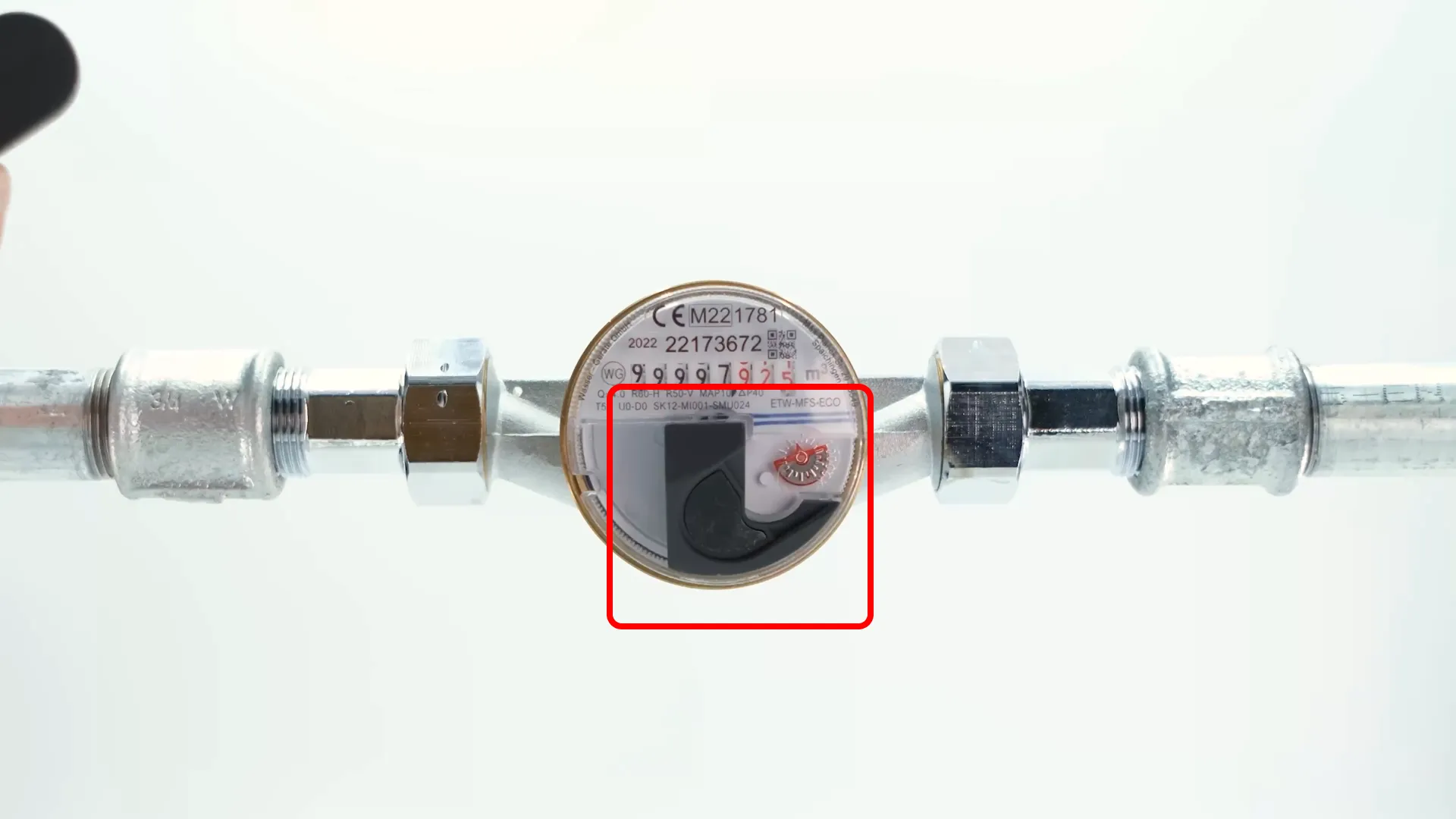

Important: Position the wasserleser sensor so that:
  • The sensor reading unit is positioned exactly above the rotating metal disc
This ensures that the pulses are precisely captured and water consumption is reliably measured.
wasserleser sensor position
wasserleser with metal disc overlapped
Step 3: Final Check
After mounting, verify that:
  • The adapter is completely stable and doesn't wobble
  • The wasserleser sits firmly on the adapter
  • The sensor is aligned with the rotating metal disc
  • All components are secure
