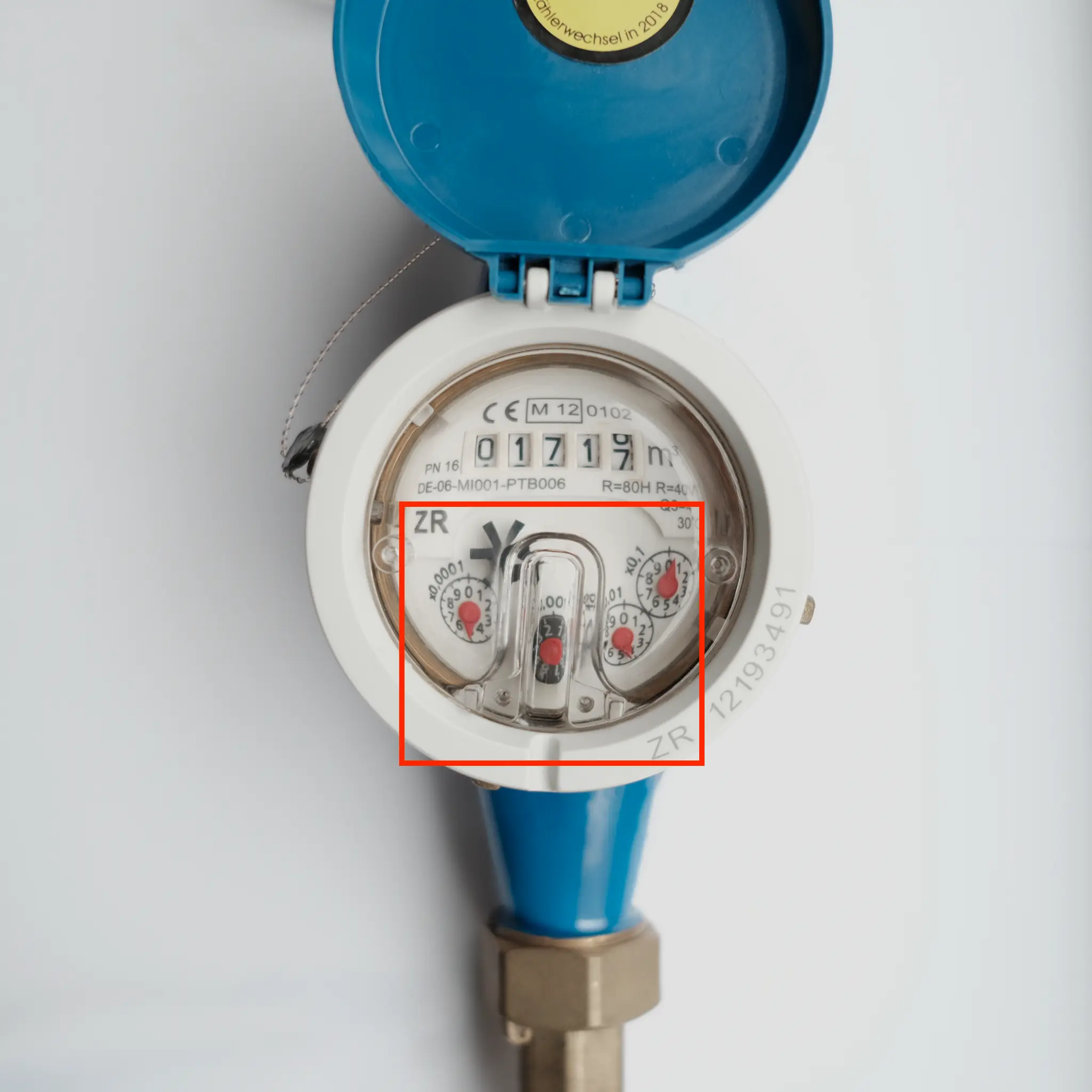

  1. Insert the reed contact into the T-shaped indentation of your Zenner meter
Insert reed contact into T-shaped indentation

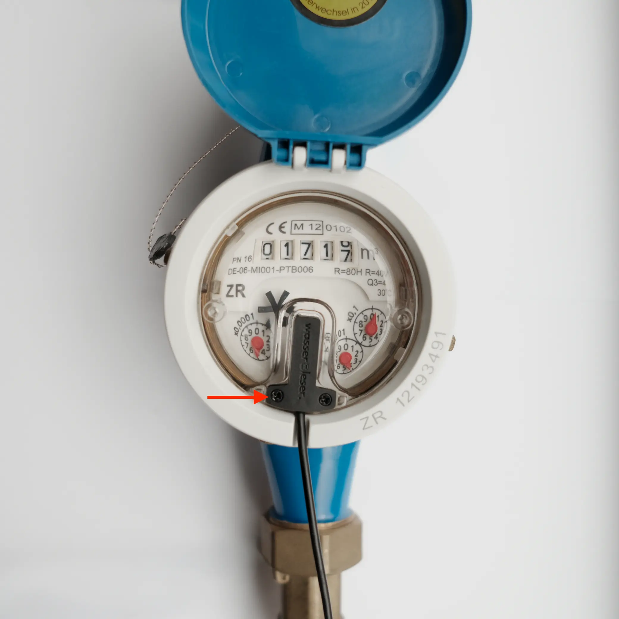

  1. Carefully tighten the reed contact on the meter using the included screws
Tighten reed contact with screws

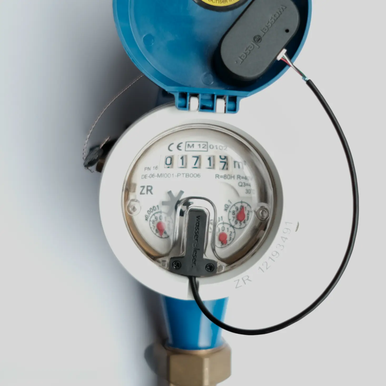

  1. Connect the reed contact via the cable to your wasserleser. The wasserleser can be placed flexibly on the meter.
Connect reed contact via cable
  1. Connect the wasserleser to power using the USB-C power adapter.
