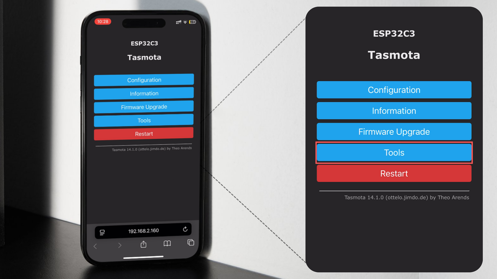

In the Tasmota menu: Tools → Edit Script
Tools → Edit Script
Open Script Editor
Click Edit Script to open the Tasmota Smart Meter Interface.

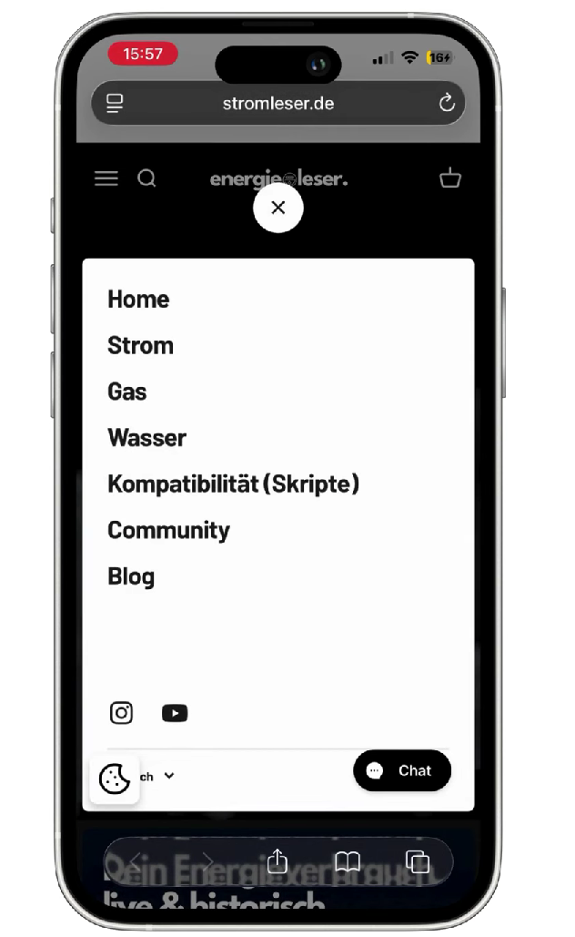

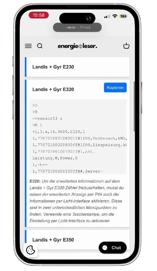

Find Script for Your Meter Model
Find the correct script for your meter model by checking your meter number (recommended: www.energieleser.de/pages/scripts).
Find meter script

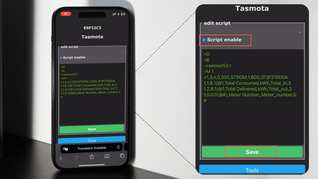

Insert and Activate Script
Copy and paste the script into the editor. Enable "Script Enable" and save.
Enable script
Activate the script by selecting "Script Enable" and save your settings.
Enable script

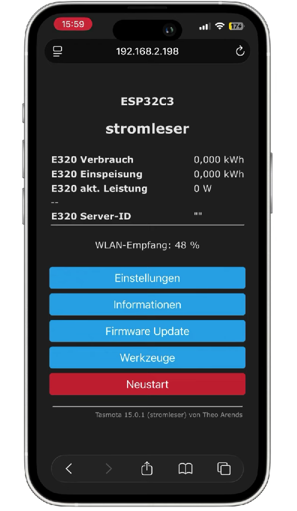

Check Values
Return to main Tasmota view.
Live meter values should appear after a few seconds.
Check live values
✅ Setup Complete!
The stromleser.tasmota is now transmitting live readings. Monitor via the Tasmota web interface or Stromleser App.
