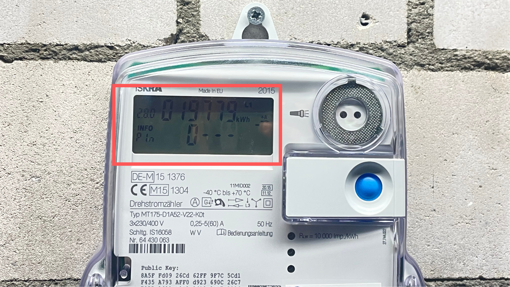

Make sure your electricity meter is unlocked in advanced mode so the Stromleser can read all values.
Unlock Meter in Advanced Mode
There are two ways to unlock your electricity meter, depending on the meter model:
Option 1: With Physical Button (if available)
If your meter has a physical button, press it to activate advanced mode.
Option 2: Via Light Interface (PIN Entry)
If your meter does not have a physical button, the PIN must be entered via the light interface.
Electricity meter unlocked in advanced mode
PIN Entry via Light Interface
The PIN can be entered either via flashlight or PIN app.
To activate with a flashlight, point it steadily at the light sensor/diode for a few seconds.
Each light pulse corresponds to a number (e.g., 5 pulses = number 5).
PIN activation via flashlight

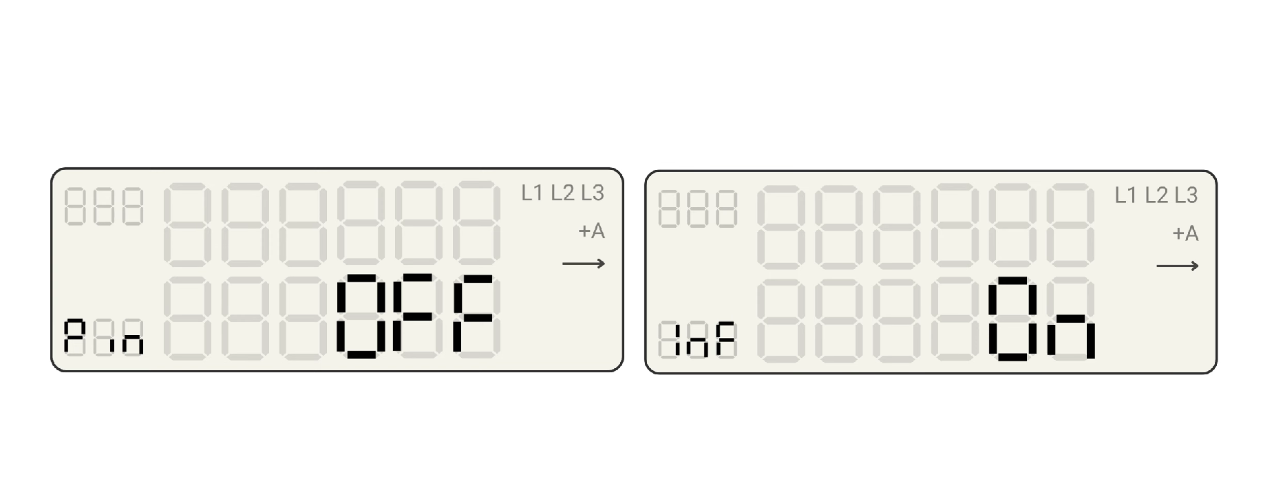

Activate Information Interface (INF to ON)
Important: INF must be ON
Make sure the information interface (INF) is set to ON. If INF is set to OFF, some values will be displayed as zero and the Stromleser cannot read all data.
Activate information interface
PIN Option to OFF (on some meters)
On some meters, the PIN option must be set to OFF to allow continuous readings.
