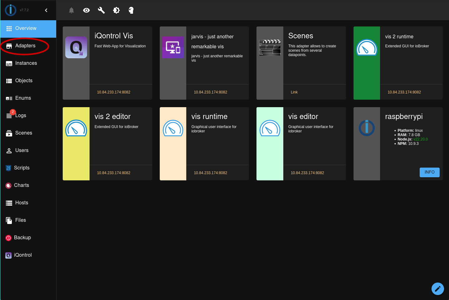

  2. Go to the Adapters tab.

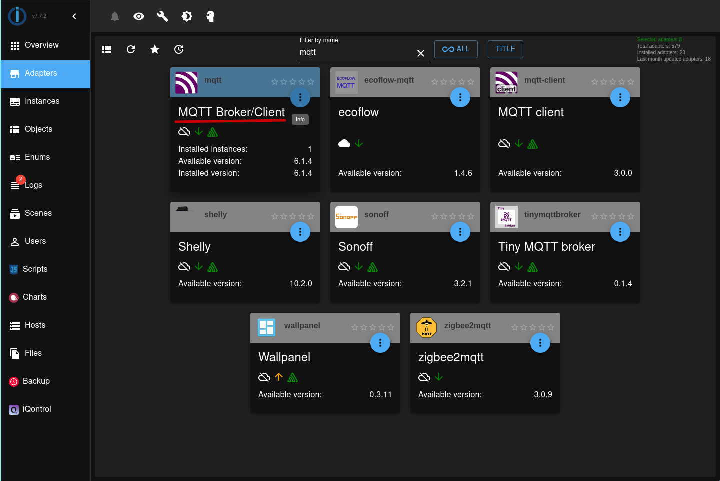

  3. Search and install the Mosquitto MQTT adapter. Install Mosquitto Adapter
  4. Create an instance of the MQTT adapter. Create MQTT Instance

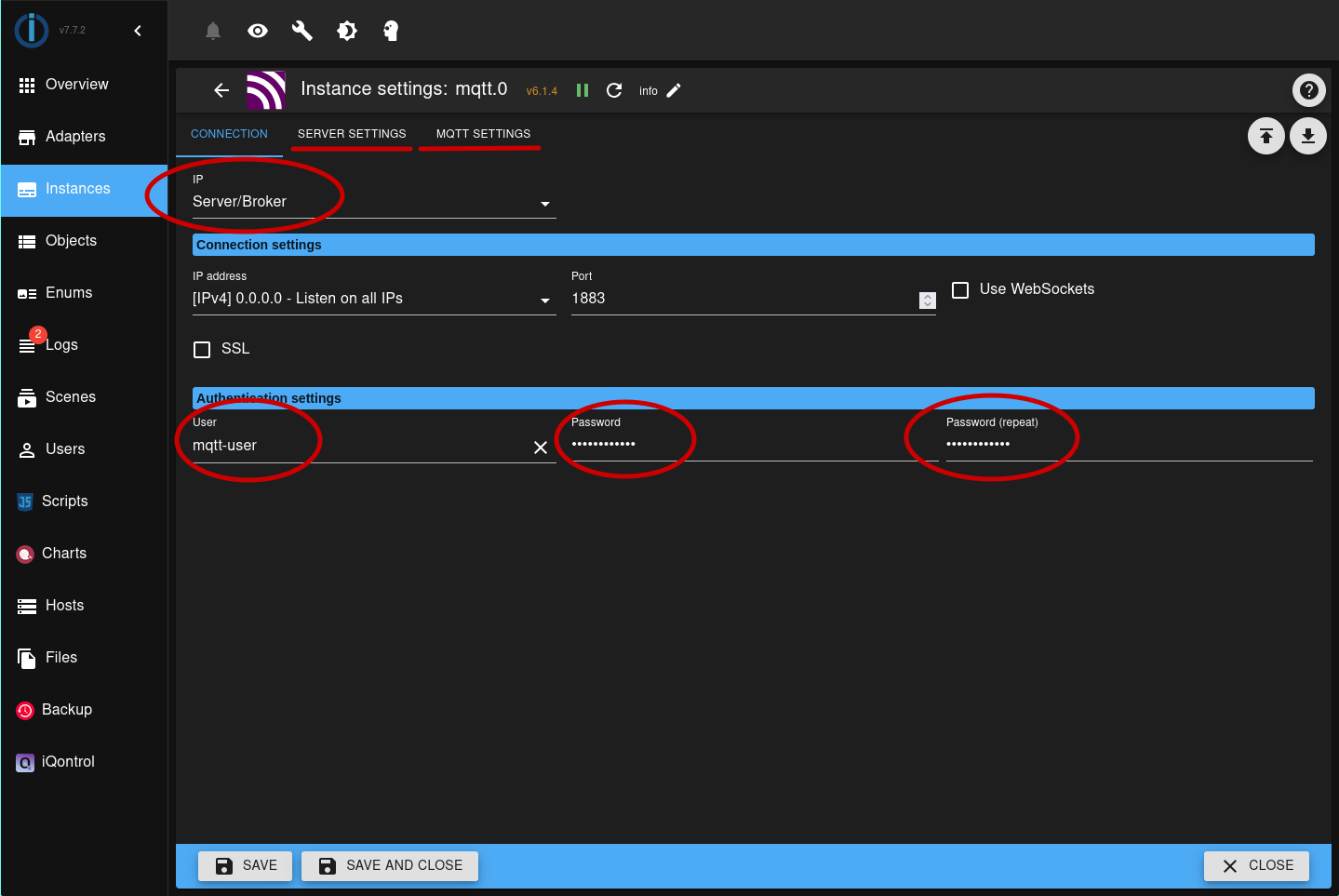

Step 2: Configure Mosquitto Broker
  1. Go to Instances tab.
  2. Click the wrench icon on the MQTT adapter instance. MQTT Configuration
  3. Under Broker Configuration:
    • Set the role as Server/Broker.
    • Set up a username and password.

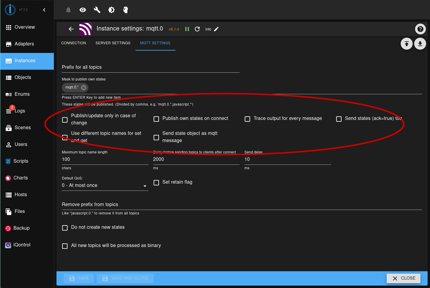

    • In the Server Settings and MQTT Settings, uncheck all options.
  4. Click Save and Start the instance. MQTT Configuration MQTT Configuration MQTT Configuration

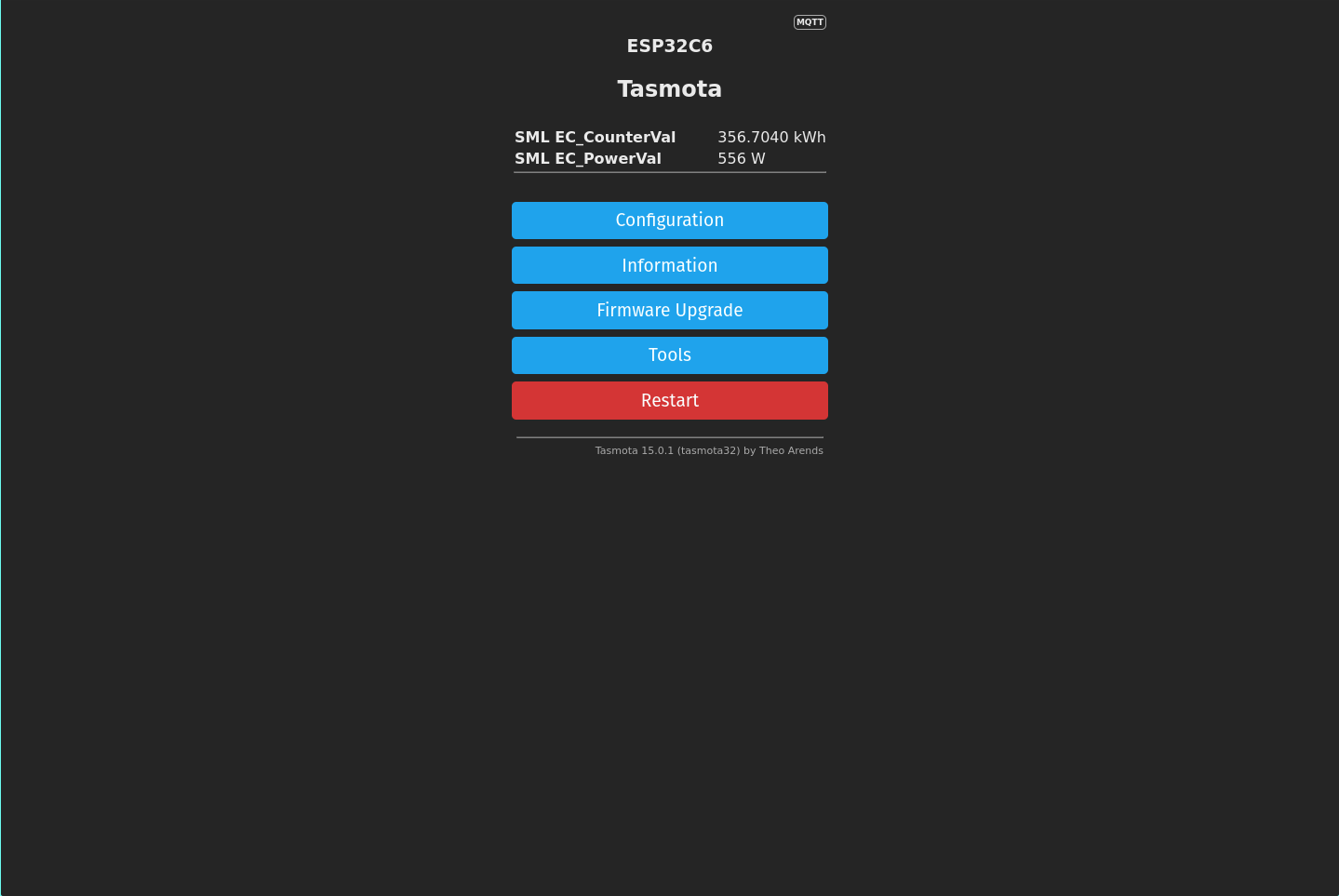

Step 3: Configure the Tasmota Device
  1. Open the Tasmota web interface of your device. Tasmota Web Interface

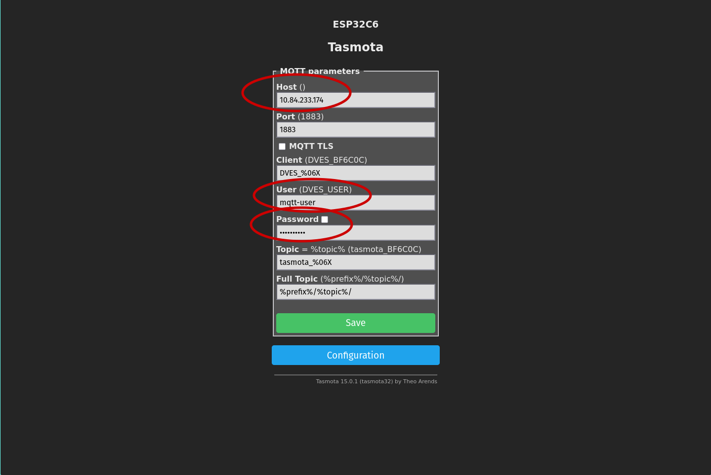

  2. Go to Configuration → MQTT.
  3. Set the following values:
    • Host: <ioBroker IP>
    • Port: 1883
    • Username / Password: (same as Mosquitto credentials) Tasmota Web Interface
  4. Leave all other fields as default.
  5. Save and restart the device.

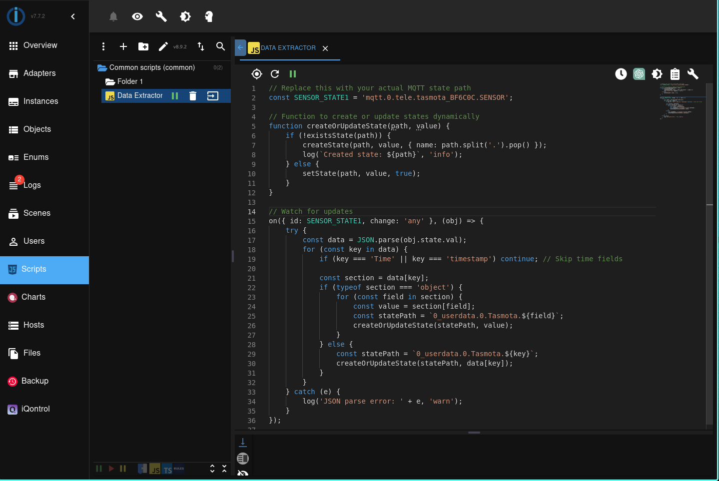

Step 5: Create JavaScript for Data Extraction
  1. Go to Scripts tab in ioBroker.
  2. Create a new JavaScript file. ioBroker Scripts
  3. Paste the following code and start the script:
// Replace this with your actual MQTT state path
const SENSOR_STATE1 = "mqtt.0.tele.tasmota_XXXXXX.SENSOR";
// Function to create or update states dynamically
function createOrUpdateState(path, value) {
if (!existsState(path)) {
createState(path, value, { name: path.split(".").pop() });
log(`Created state: ${path}`, "info");
} else {
setState(path, value, true);
// Watch for updates
on({ id: SENSOR_STATE1, change: "any" }, (obj) => {
try {
const data = JSON.parse(obj.state.val);
for (const key in data) {
if (key === "Time" || key === "timestamp") continue; // Skip time fields
const section = data[key];
if (typeof section === "object") {
for (const field in section) {
const value = section[field];
const statePath = `0_userdata.0.Tasmota.${field}`;
createOrUpdateState(statePath, value);
} else {
const statePath = `0_userdata.0.Tasmota.${key}`;
createOrUpdateState(statePath, data[key]);
} catch (e) {
log("JSON parse error: " + e, "warn");

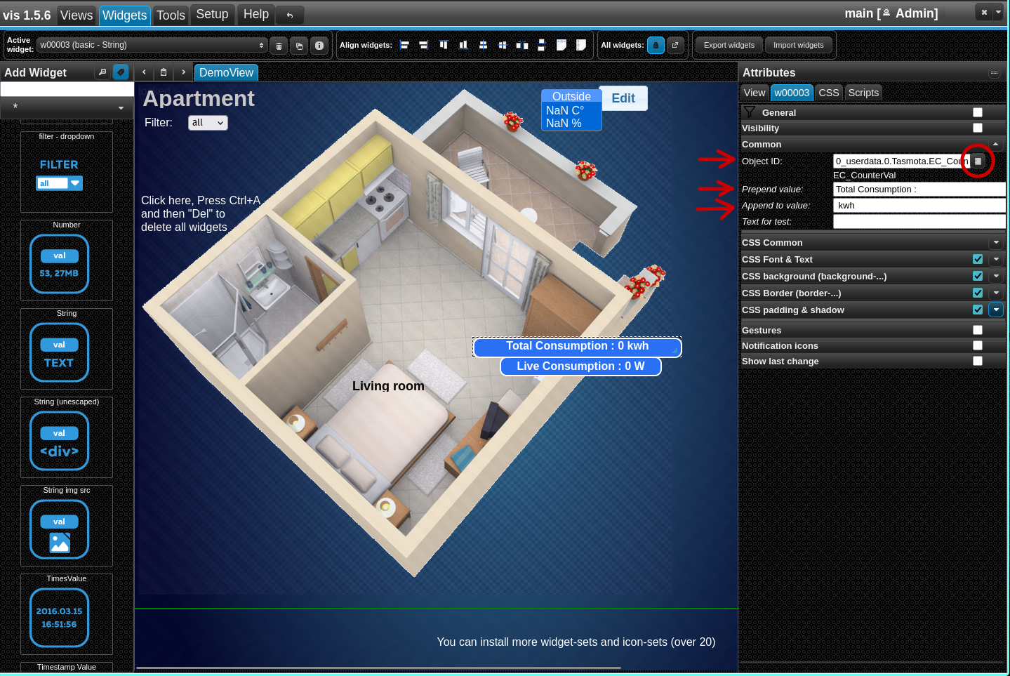

Step 6: Setup Visualization (VIS)
  1. Go to Adapters → install the VIS (Visualization) adapter.

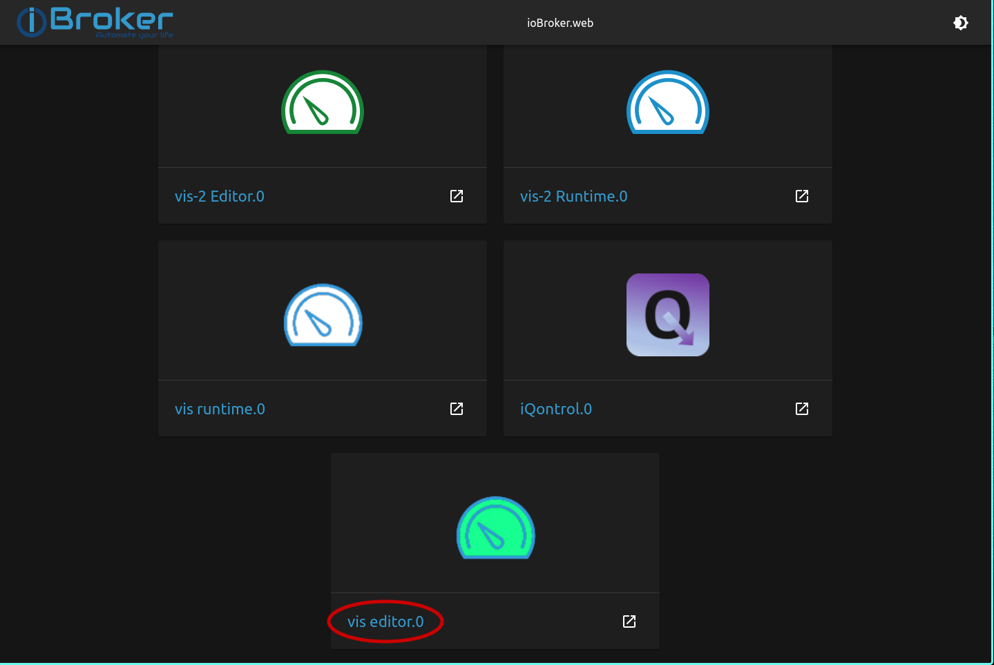

  2. Open VIS Editor at:
    http://<ip>:8082
    VIS Editor
  3. Choose VIS Editor 0. VIS Editor

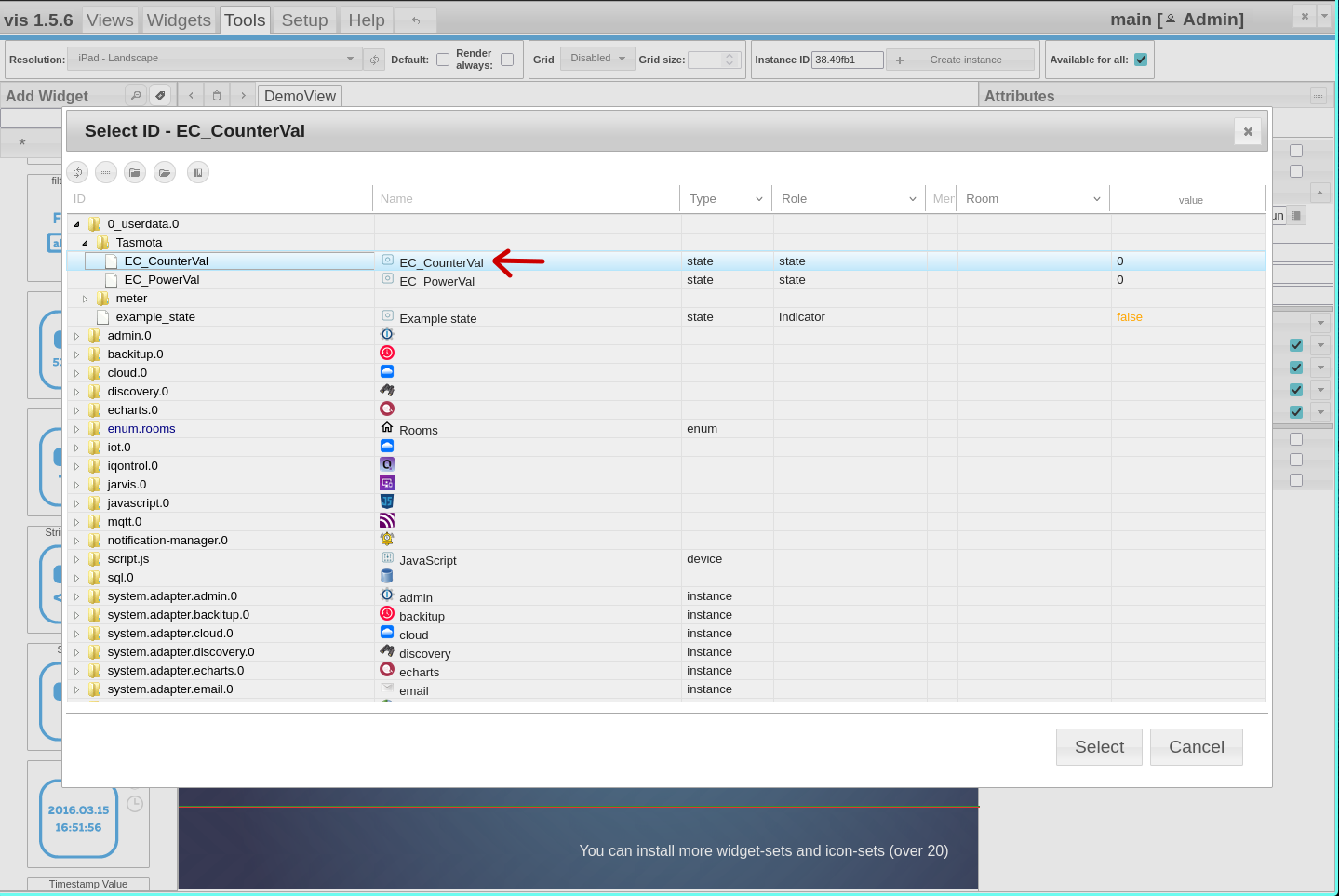

  4. Add Text Widgets and use the following Object IDs:
    • 0_userdata.0.Tasmota.<value_1>
    • 0_userdata.0.Tasmota.<value_2> VIS Editor
  5. Adjust CSS, position, and append/prepend formatting as desired.
  6. Similary can be done for other values too.
  7. Click Close.
