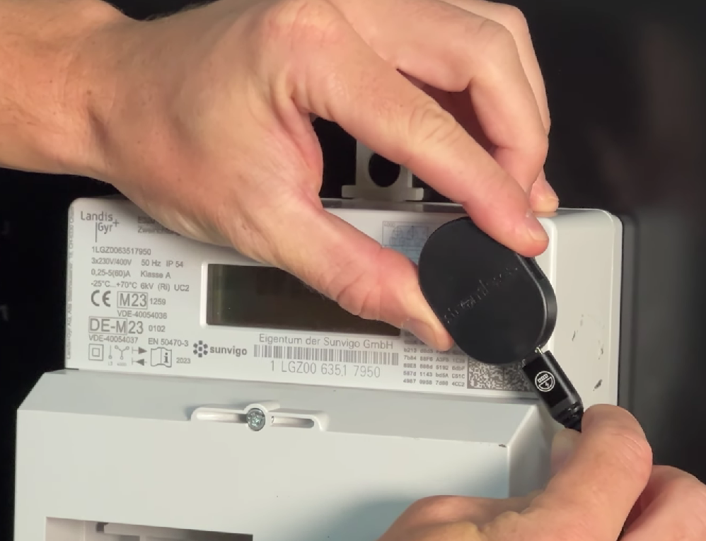

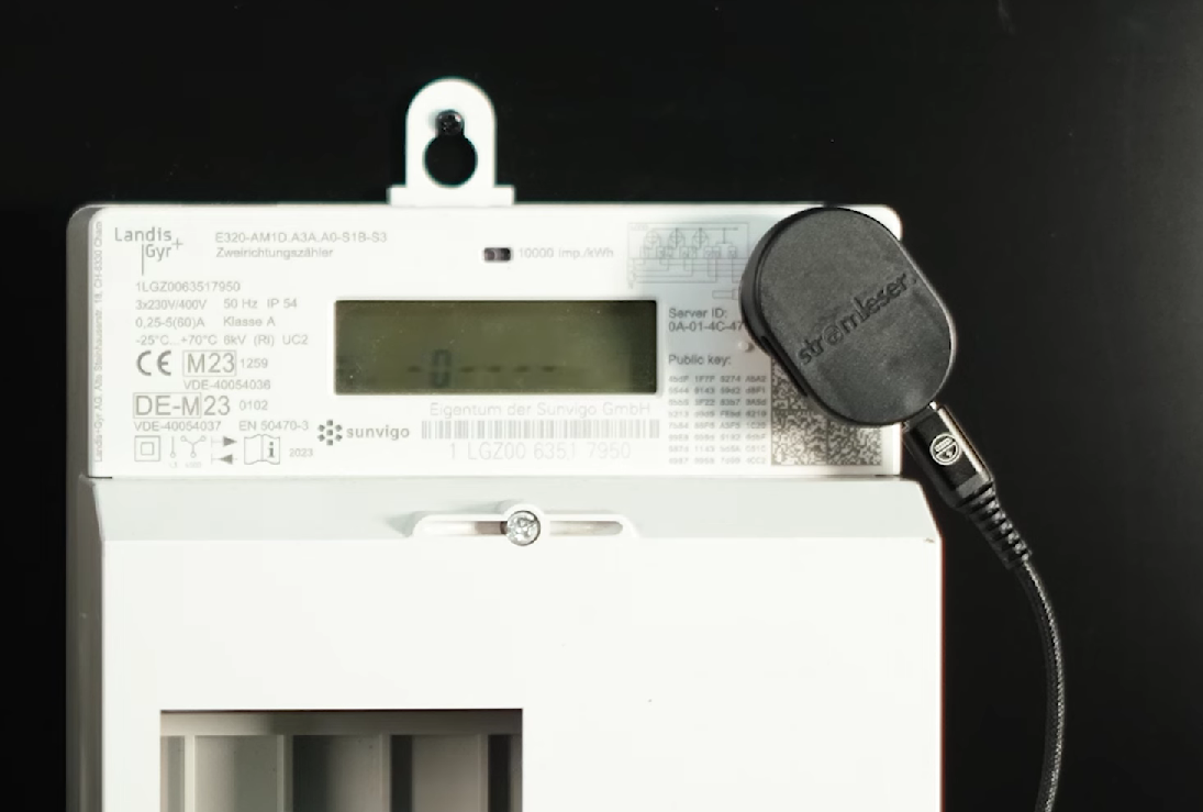

Connect Stromleser to Meter
Securely attach Stromleser to the optical interface of your meter.

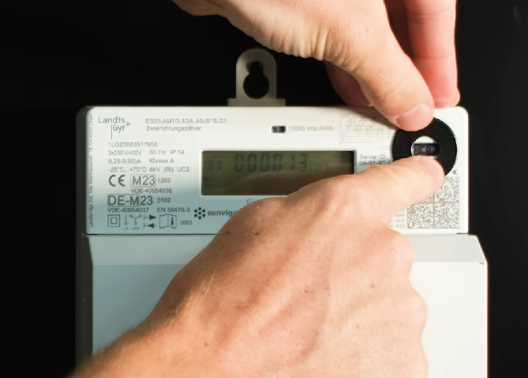

Place the metal disc on the meter surface.
Magnetically attach the reader to the disc.
Align LED with sensor. If readings are not detected, adjust rotation (30°) or tilt (up to 45°).
