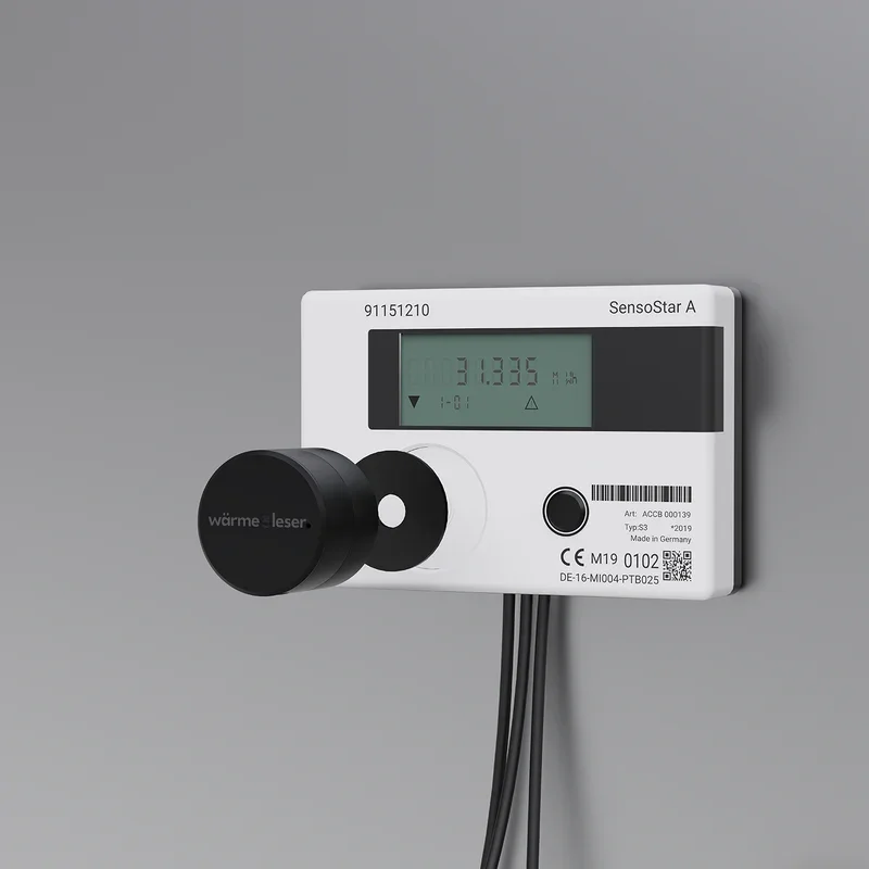

Manual reset (hardware)
If the app is not available:
To reset the device, press and hold the reset button (see Fig. 1 in Installation) for 7 seconds.
Use the metal pin
Use the metal pin we supplied and carefully press into the opening to activate the button. If the LED flashes blue rapidly, the reset was successful.
- Find the reset button on the device
- Hold the button for 7 seconds
- Wait until the LED flashes blue rapidly (reset successful)
- The device restarts
