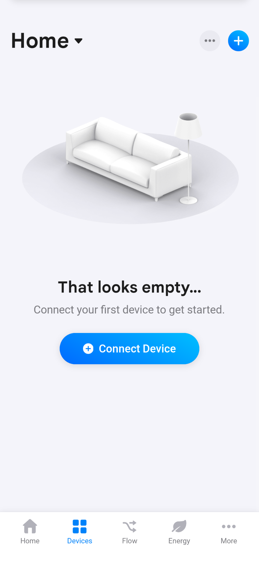

Step 1: Open the Devices tab & add a new device
  1. Open the Homey app on your smartphone.
  2. Tap Devices (the grid icon) at the bottom.
  3. Tap the + icon in the top right — or tap Connect Device if your device list is still empty.
Homey Devices tab empty – Connect Device

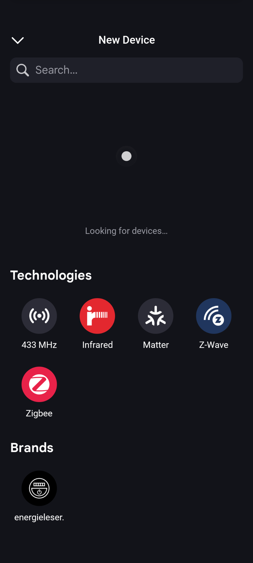

Step 2: Select energieleser under "Brands"
  1. The New Device screen opens — Homey automatically scans for nearby devices.
  2. Scroll down to the Brands section.
  3. Tap energieleser.
New Device – energieleser under Brands

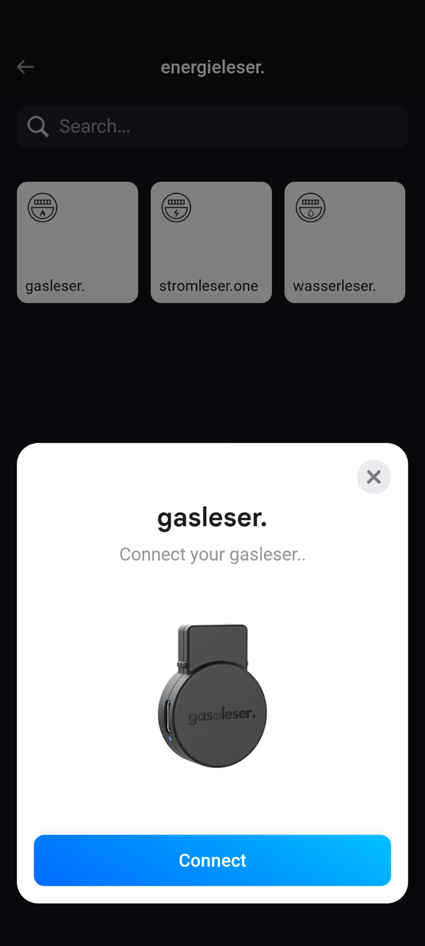

Step 3: Choose your device type & start pairing
  1. You will see the three available energieleser devices:
    • gasleser.
    • stromleser.one
    • wasserleser.
  2. Tap the device you want to add. A dialog appears asking you to connect your device.
  3. Tap Connect.
energieleser device selection and connect dialog

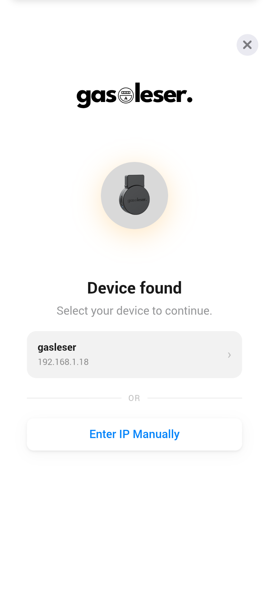

Step 4: Select your device
  1. Homey now searches your network for the device.
  2. Once found, the Device found screen appears showing the device name and IP address.
  3. Tap your device in the list to select it.
Enter IP manually
If your device is not found automatically, tap Enter IP Manually and type in your device's IP address.
You can find the IP address in the energieleser app: Tap your device → gear iconDevice Information.
Device found – select your device from the list

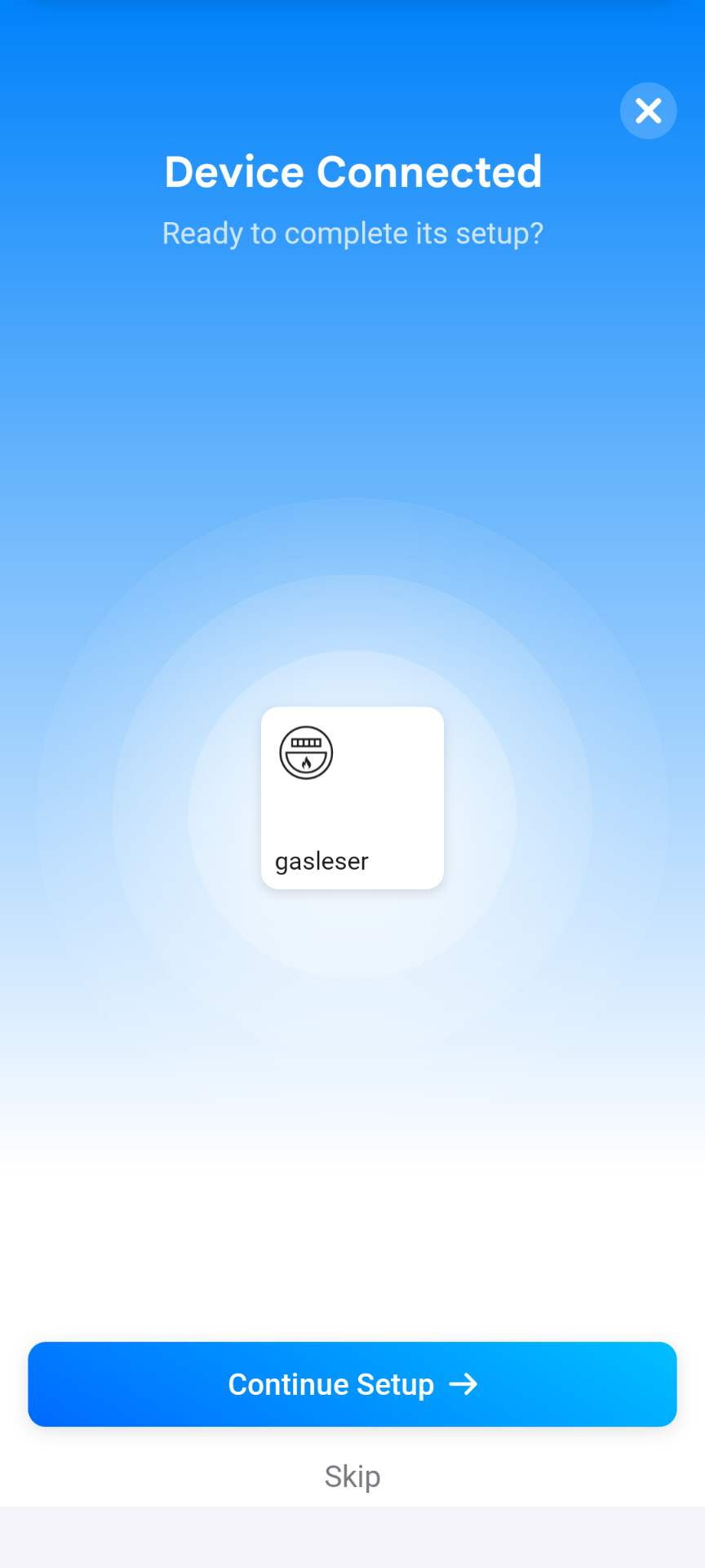

Step 5: Confirm the connection
  1. Homey confirms the successful connection with the Device Connected screen.
  2. Tap Continue Setup to personalize your device — or tap Skip to finish immediately.
Device Connected – Continue Setup or Skip

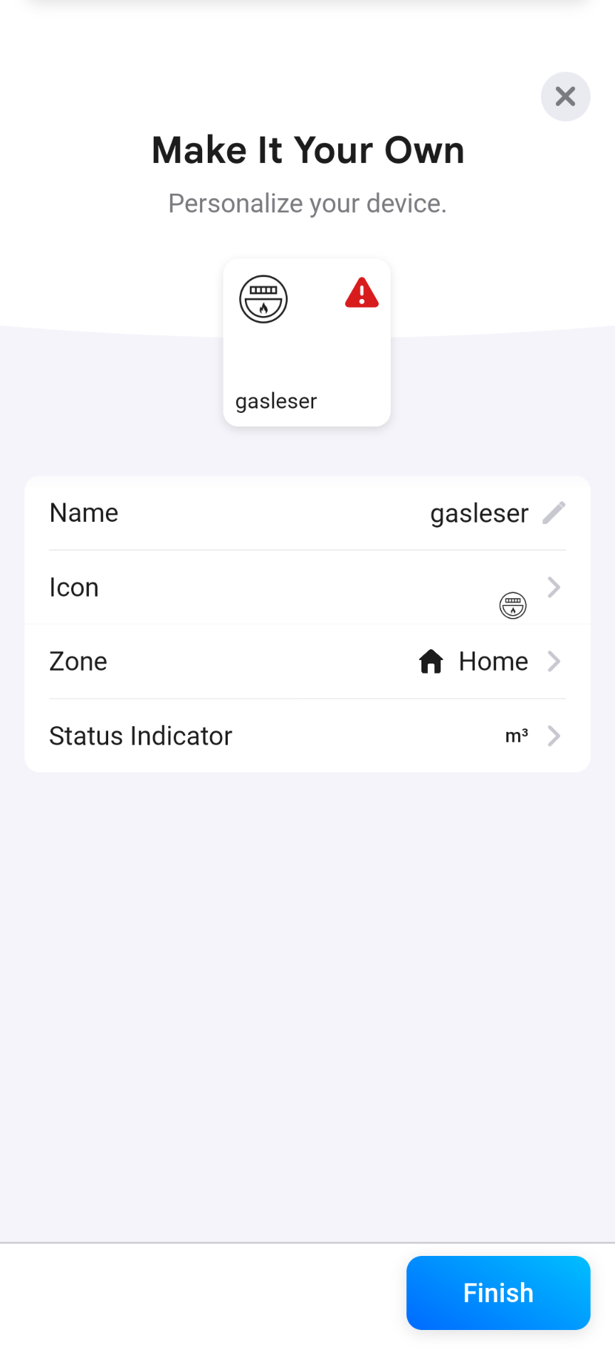

Step 6: Personalize your device
  1. On the Make It Your Own screen you can set:
    • Name: Give your device a custom name
    • Icon: Choose a suitable icon
    • Zone: Assign the device to a room (e.g. "Home", "Basement")
    • Status Indicator: Choose which unit appears on the device tile
Make It Your Own – Name, Icon, Zone, Status Indicator

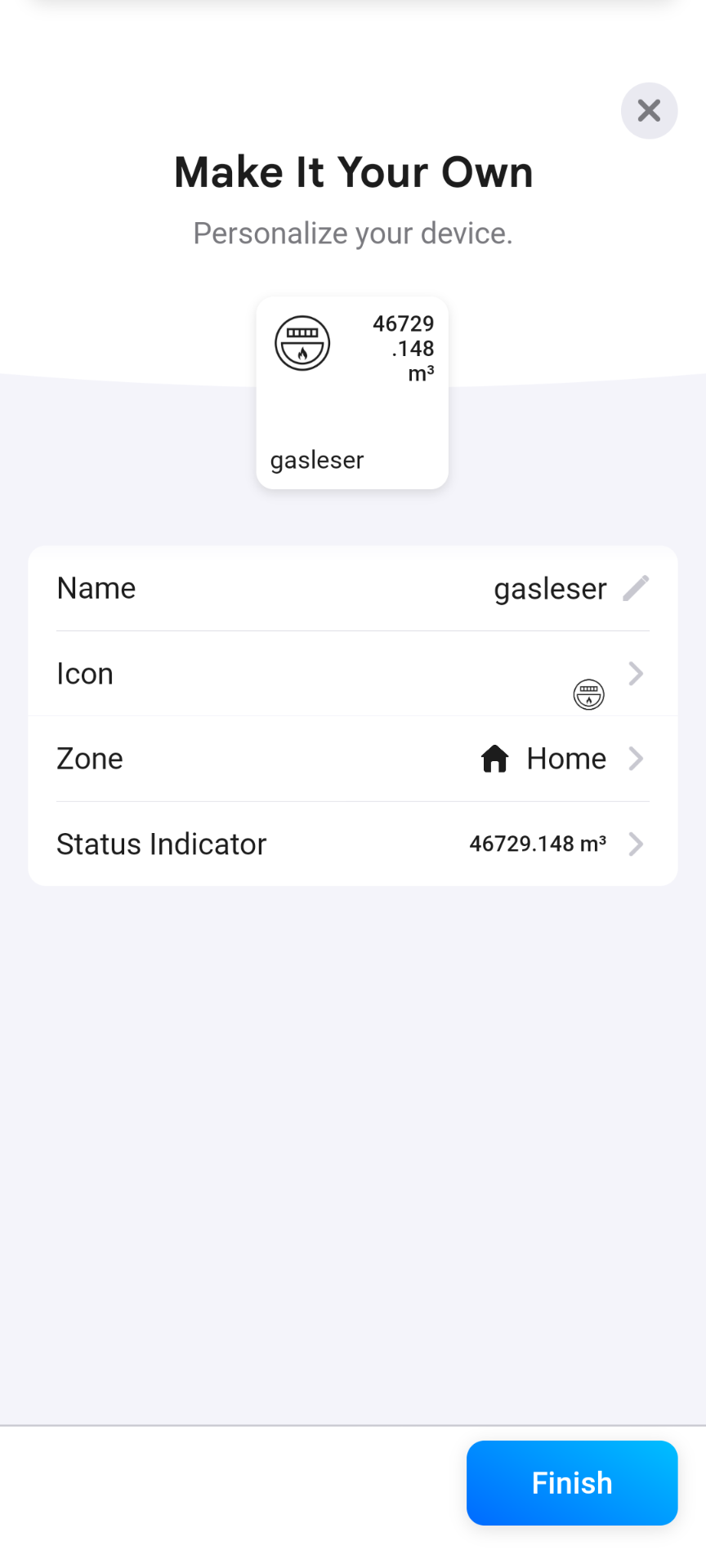

  1. As soon as the device delivers data, your current reading appears on the preview tile.
Make It Your Own – live data shown on preview tile
  1. Tap Finish when you are done.

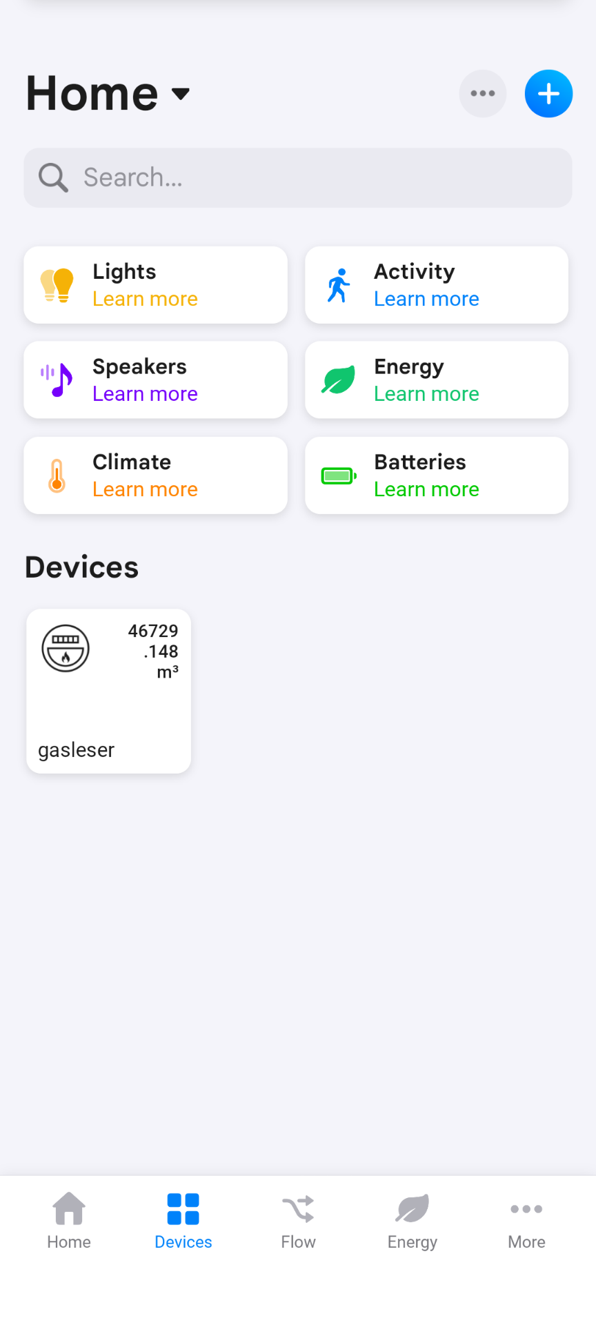

Step 7: Done!
Your device is now successfully added to Homey and appears in the Devices tab as a tile showing your live readings.
Devices overview – gasleser successfully added

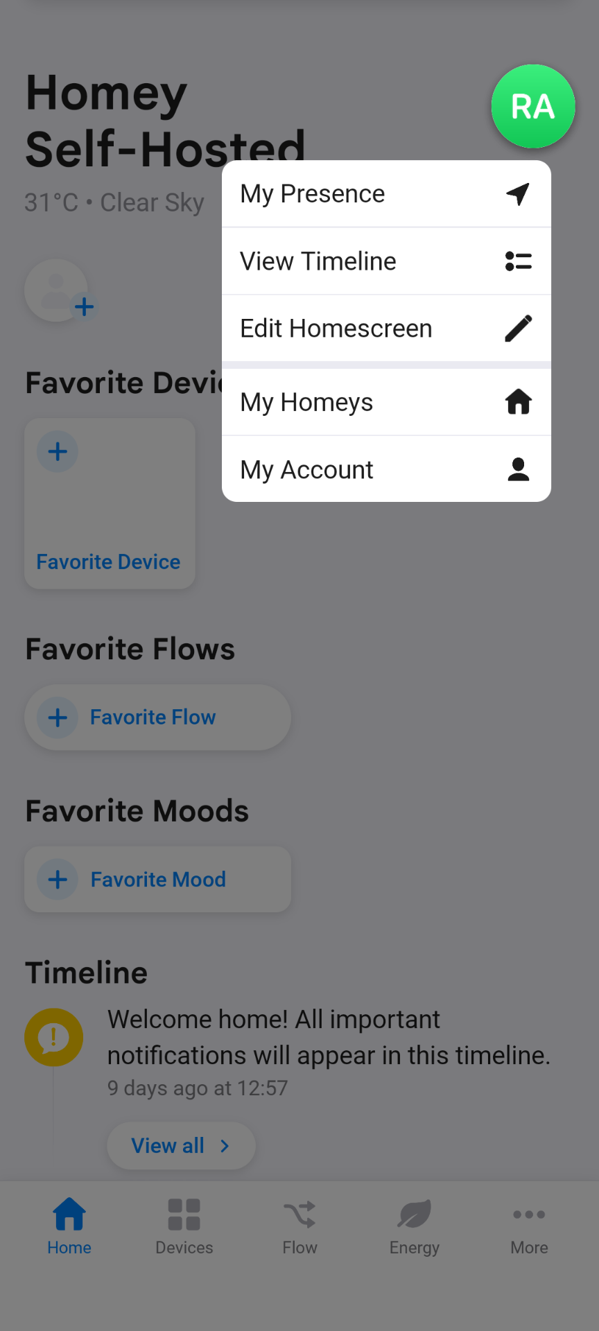

Step 1: Open the home screen editor
  1. Open the Homey app and go to the Home screen (house icon at the bottom left).
  2. Tap your profile picture (colored circle with your initials) in the top right.
  3. In the menu that appears, tap Edit Homescreen.
Profile menu – Edit Homescreen

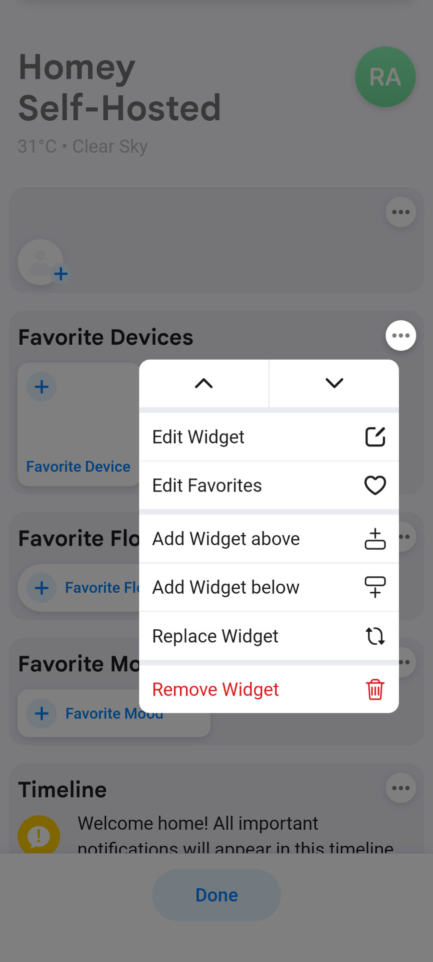

Step 2: Add a widget
  1. The home screen is now in edit mode — tap the ··· icon next to an existing widget or tap a + area.
  2. In the context menu, choose Add Widget above or Add Widget below.
Widget edit menu with options

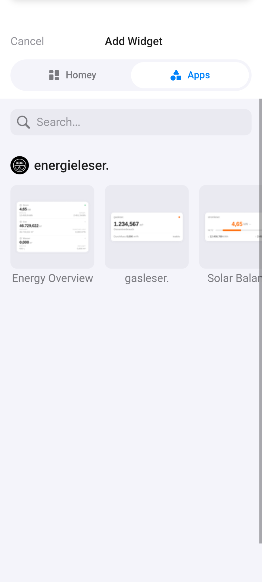

  1. The Add Widget screen opens. Switch to the Apps tab at the top.
  2. Scroll to energieleser. and tap the widget you want.
Add Widget – select an energieleser widget

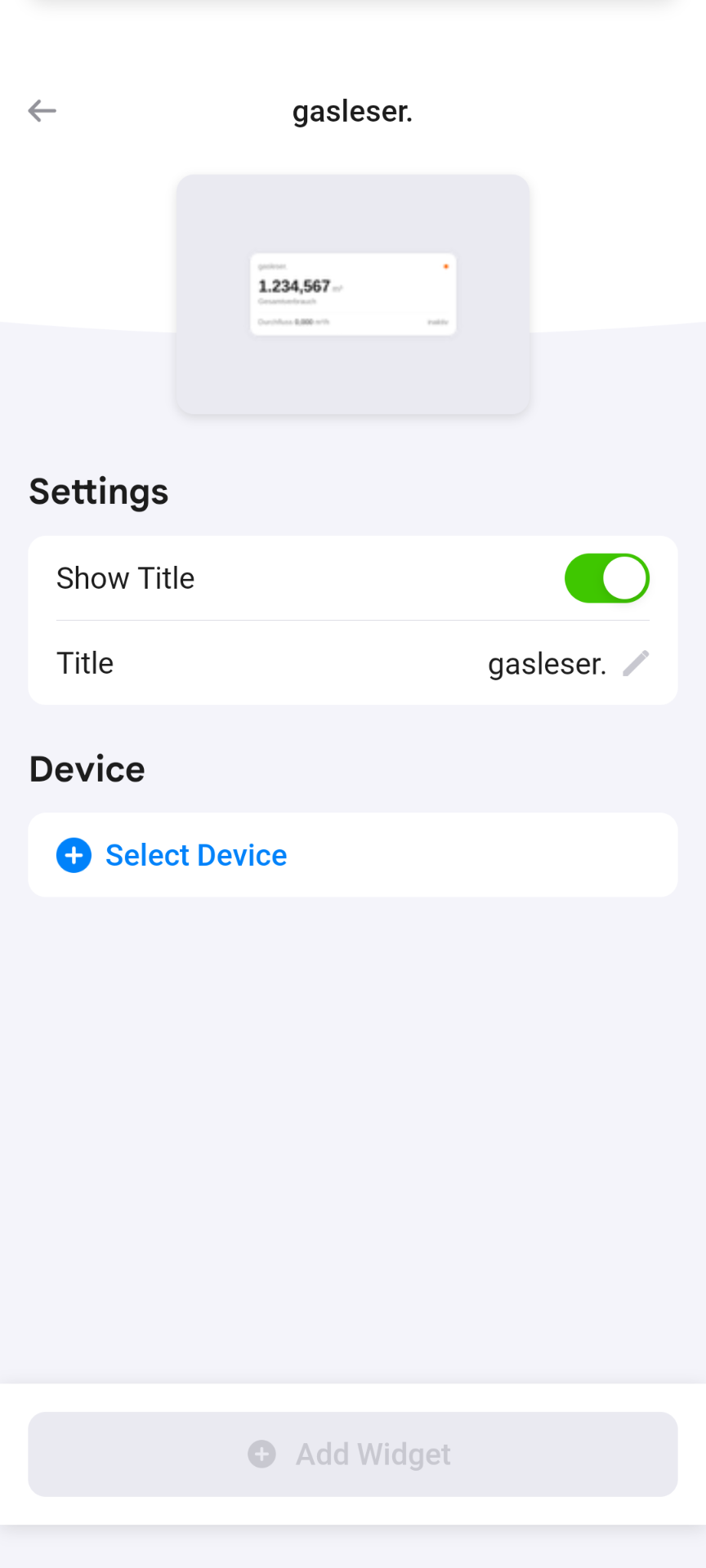

Step 3: Configure the widget & select a device
  1. You now see the widget configuration screen with a live preview.
  2. Under Settings you can:
    • Toggle Show Title on or off
    • Edit the Title displayed on the widget
  3. Under Device, tap Select Device and choose your energieleser device from the list.
  4. Tap Add Widget to confirm.
Configure widget – select device and set title

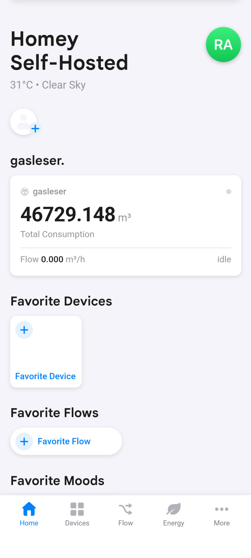

Step 4: Done — widget on your home screen
The widget now appears on your Homey home screen showing your live readings.
Homey home screen with gasleser widget – live data
