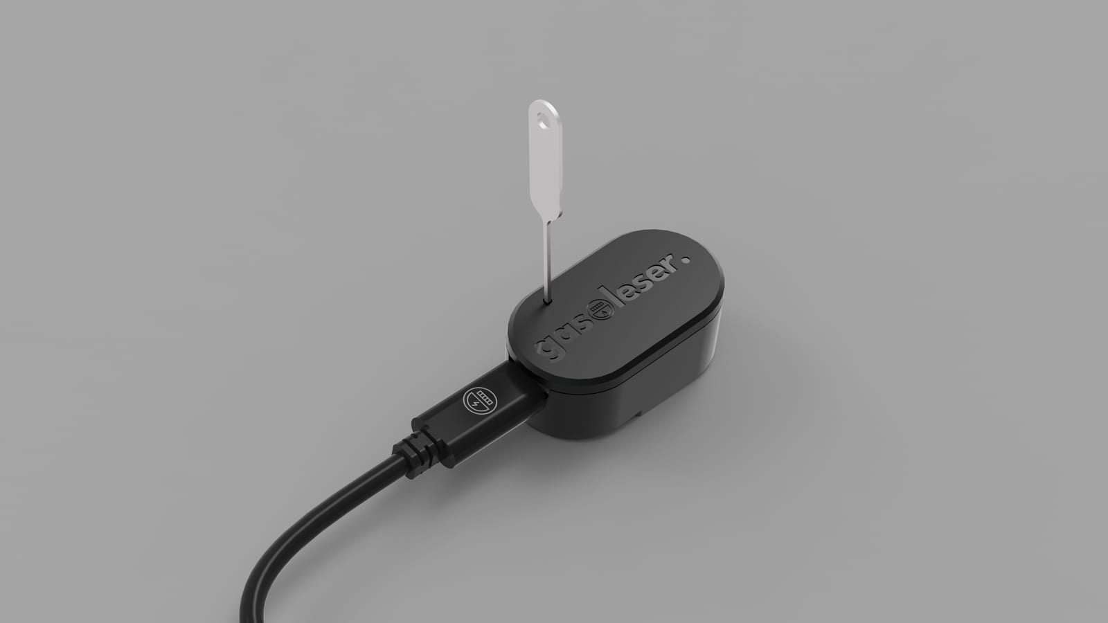

Manual Reset
To manually reset the gasleser.pulse to factory settings:
  1. Use a SIM ejector tool or similar
  2. Insert the tool into the reset opening
  3. Hold the internal reset button for 9 seconds
  4. The device will be reset to factory settings
  5. All stored data will be removed
SIM ejector tool inserted into the reset opening on top of the gasleser.pulse
