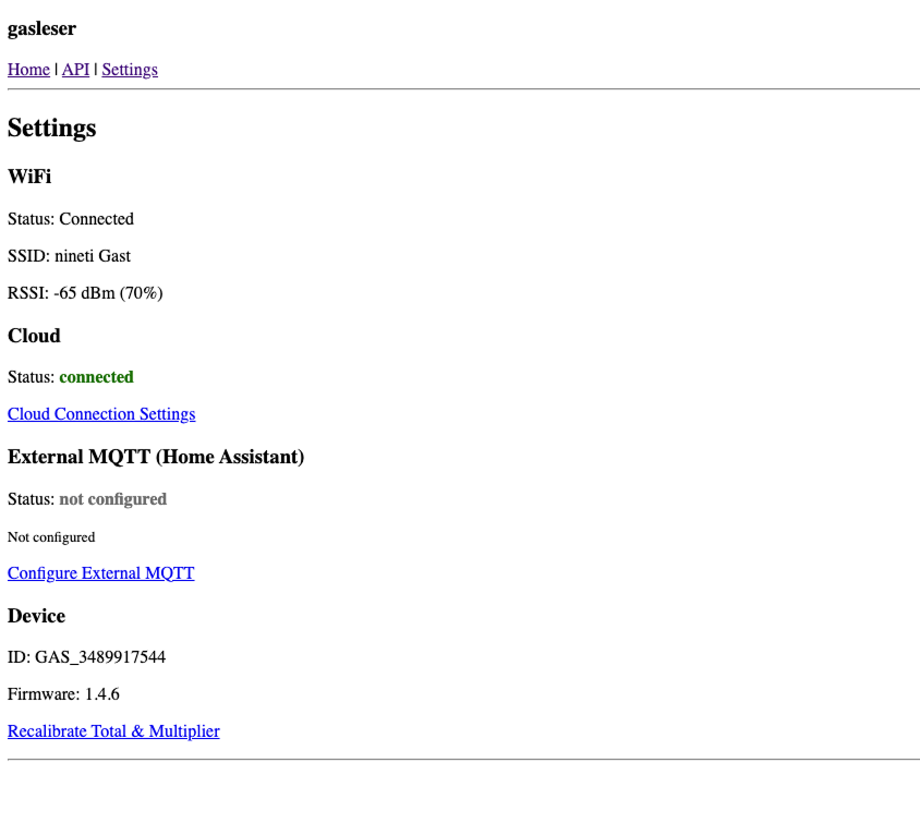

Step 2: Go to Settings
- Click Settings in the navigation.

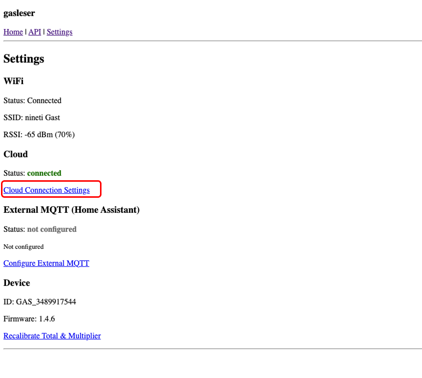

Step 3: Open Cloud Connection Settings
- In Settings you'll see the Cloud section with the current status (e.g.
connected). - Click Cloud Connection Settings.

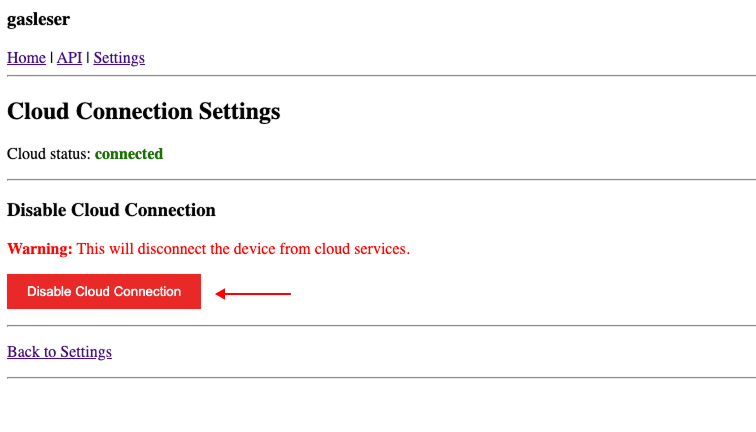

Step 4: Disable cloud connection
- Click Disable Cloud Connection.

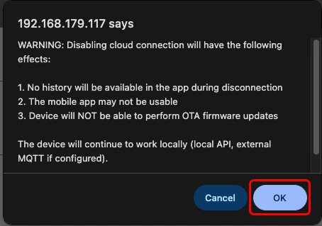

- A warning dialog appears listing the effects:
The effects in detail:
- No history will be available in the app during disconnection
- The mobile app may not be usable or only limited
- The device will NOT be able to perform OTA firmware updates
Important: The Gasleser will continue to work locally (local API, external MQTT if configured).
- Confirm the dialog to disable the cloud connection.

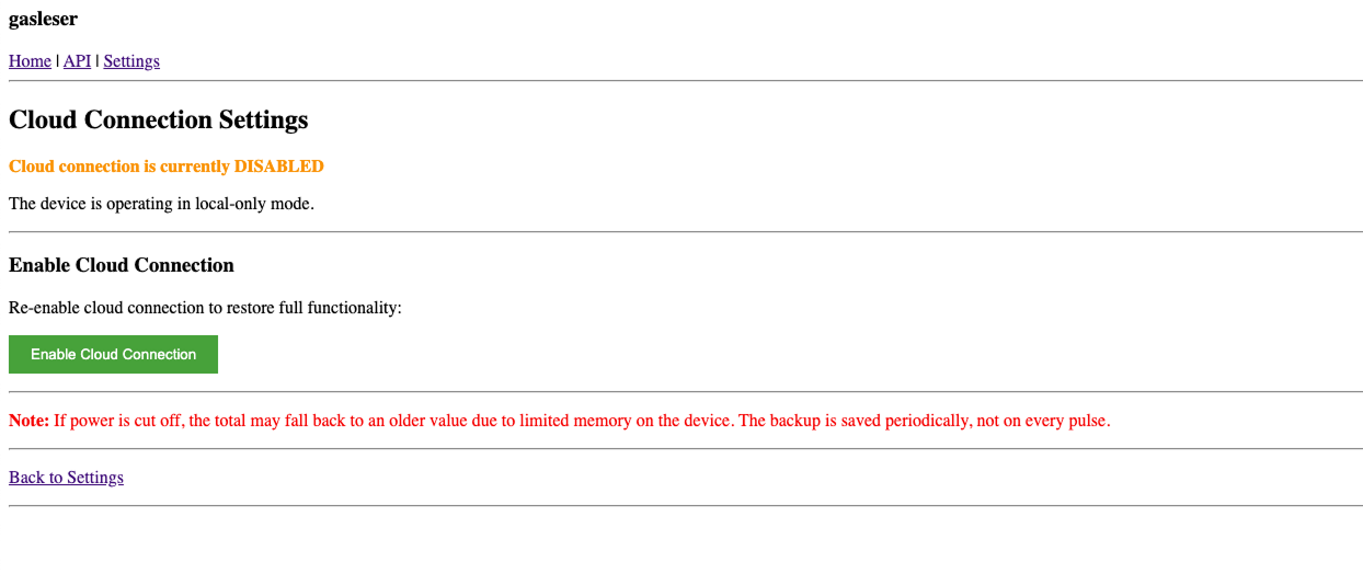

Step 5: Check the status
After disabling, you'll see:
- In Cloud Connection Settings you now see that the cloud connection is disabled
(for example: "Cloud connection is currently DISABLED"). - A button Enable Cloud Connection appears, which you can use to re‑enable the cloud at any time.
Note: In the general Settings, the cloud status will now show as "not configured":
