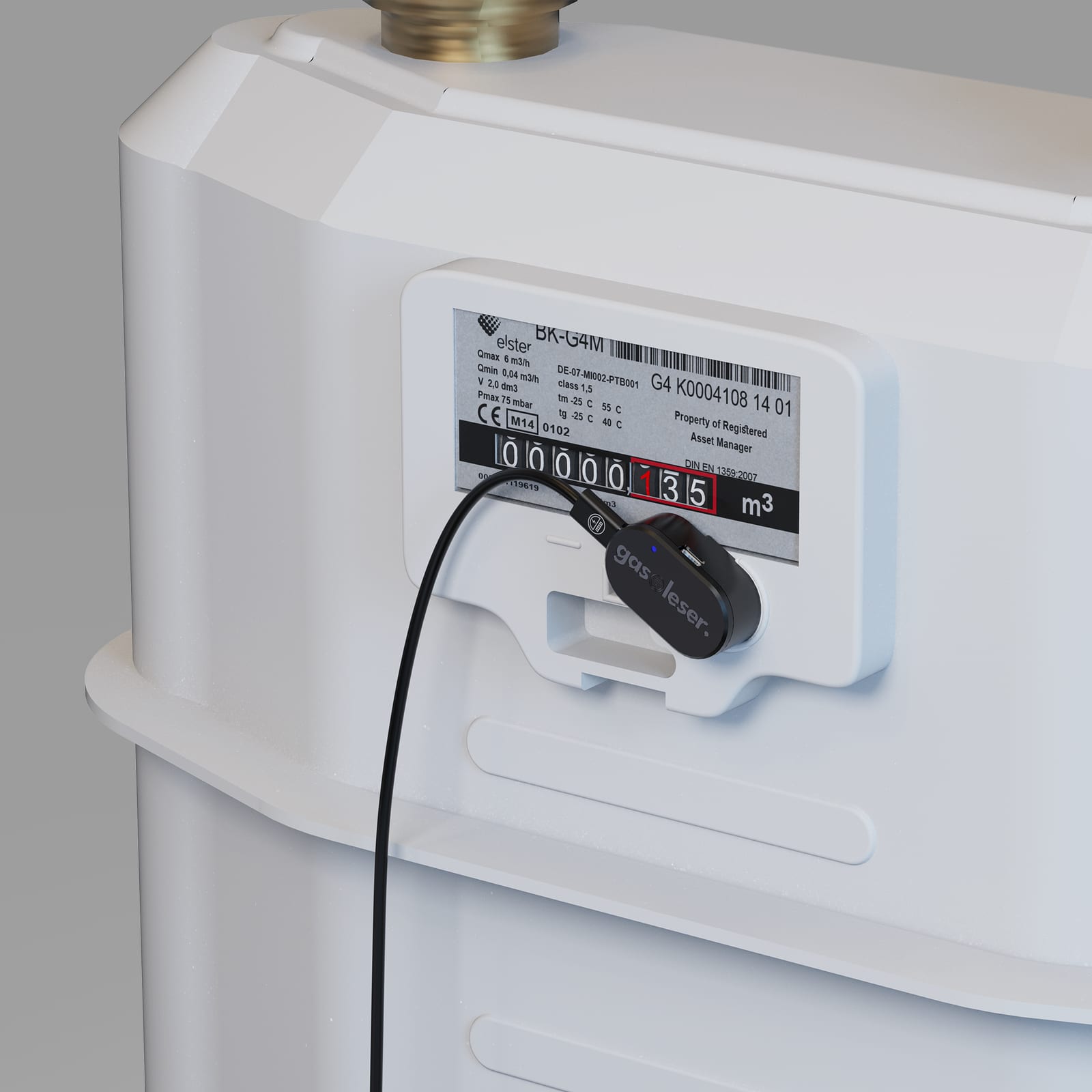

Step 2: Connect USB-C Cable to the gasleser.pulse
Connect the USB-C cable of the power adapter to the port on your mounted gasleser.pulse.
USB-C cable plugged into the mounted gasleser.pulse
Let the cable hang down loosely. That way nothing tugs at the device and pulls it out of position.
